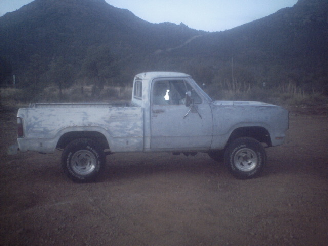

I bought my PW from a neighbor in 07 and it was almost a basket case. The only original sheet metal is the cab shell, hood, & grille. Everything else came from salvage trucks. Likewise, the interior was trashed and everything in it had to be replaced from floor pans to seat to the dash and every part attached to it. At one time there had been a fire in the dash due to a short in the ammeter. Wire harnesses are NOS military harnesses for the M880. The truck was not originally a stepside. I replaced the trashed fleetside bed with the current one. The engine is a 372ci. SBM (360ci bored .060"). An intake manifold gasket replacement turned into a timing chain replacement and snowballed into a full-on performance overhaul. While I had the eng. out I figured I might as well overhaul the trans. too and it's no longer stock either. I did a master overhaul kit install, found a couple internal pieces were worn badly and replaced them, finally installed a Trans-go shift improvement kit in the valve body. Everything is documented on my cardomain page. The rear axle and t-case haven't required any overhaul yet. The front axle needed one balljoint and a couple hubs and rotors/pads replaced. She's not a show truck and probably never will be but its a fun truck to have and drive. It's not a Macho but I think it is pretty Macho, :lol:
File comment: What it looed like when I bought it.

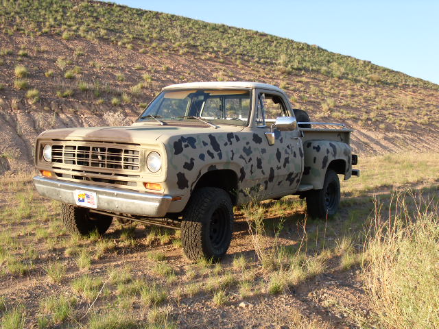

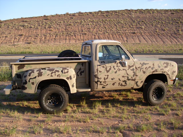

Here's the camo PW:

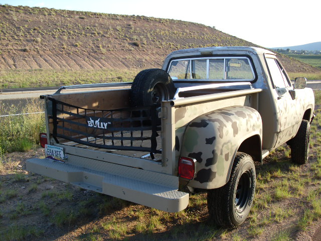

Rear view:

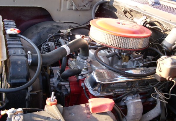

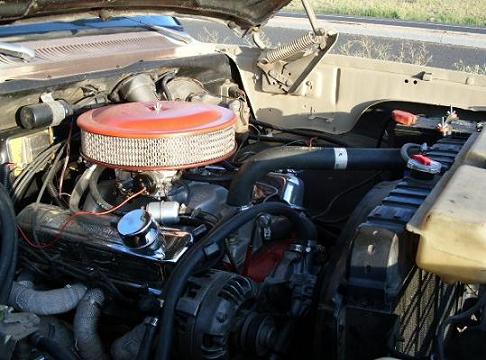

Engine:
