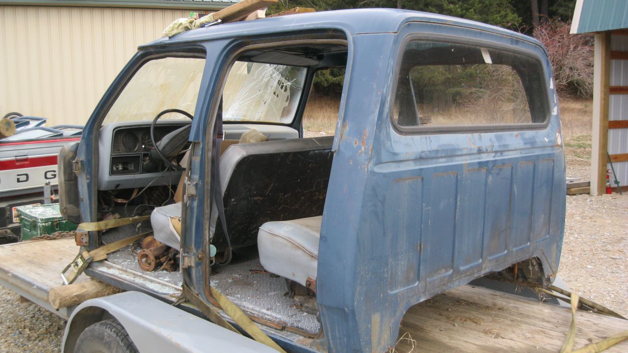

Hauled a 81 4door cab to a friends house and came back 3 weeks later and it went from this:

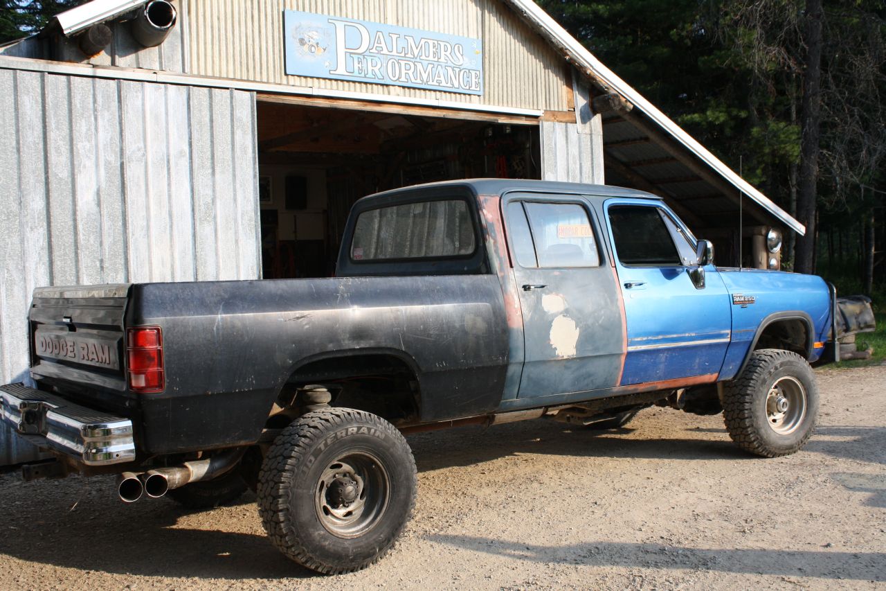

To this in three weeks!!
He took a '92 club cab and swapped the body. Cummins auto 4x4. Looks like he's tying up the loose ends and will be on the road soon!
His wife said he had to have it done by October! Motivation!
-J
(I'm not too quick to post! You beat me!)

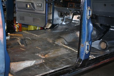

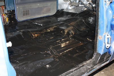

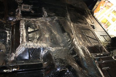

He put just a 1 1/2" body lift and then actually had to cut and raise the rear floor area (fab) approx 3inches to clear the club cab frame sweeping up. He didn't want a huge body lift. I think it's just the right height, still have to be careful stepping out. See some pics!
Floor was POR15'd and then added generic Dynamat (134$ for 100sq. feet) on the floor, firewall, rear wall, and doors. Great sound proof I think..
-J
