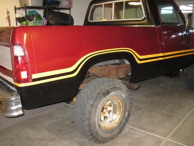

Did my first set of stripes this weekend, so I am
not an expert. But here's a few things I learned.
And I hope some of you guys that have done a
few sets will chime in here, and share what you know.
This is a Phoenix Graphics kit. Oddly it is for a 77-78
but included an extra set of the 79-80 style hood stripes.
It also includes stripes for the wheels, even though the
wheel pinstripes were originally painted.
Temperature: The instructions say 70-90' and NOT in sun.
This is their first Instruction and probably more critical than
you would think. Warm enough for the decals and not so
hot that the moisture evaporates too quickly.

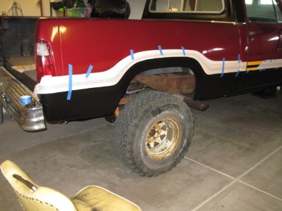

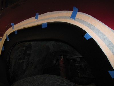

Place decal in the proper location and secure with masking tape.
This takes some time with these long stripes and the compound
curves in the fenders. It helps a lot to have a helper. I then made
locator marks with more masking tape to guide placement after
taking off the backing paper. You must spray the surface with
water softened with a few drops of soap.
Don't press hard until the entire piece is where you want it.
I did this by Putting the stripe in place. Putting down more
masking as markers, then taking the backing off a one foot
portion. Securing it. Then taking the rest back up, exposing the
adhesive, and laying it back down following my markers.
When it all looked right, then pressing the bubbles and moisture
out with a squeegee and a rag.
It is also very important to let it dry for several hours before
pulling off the premask paper. Pull it close to the surface of the decal and at an
angle. Additional bubbles can still be removed with a soft cloth
and some pressure or by sticking a pin in them.
The hard parts. The front fenders are a compound curve and may require some trimming. It is also a little tricky to cut out the notches for the tail lights
and line up the yellow band that wraps around to the Tailgate.
Couple other pointers:
Make sure you clean the area for the wrap arounds. Like door and fender
edges, and the front of the bed. Originally they wrapped anywhere from
a 1/4 of an inch to a couple inches like the bed front.
Most of the original 77-78 hood stripes I've looked at
are about 5/8 to 11/16 from the edge of the hood.
Note that the cowl pieces are curved slightly, and are left and right.
Used correctly they will look straight on the truck when viewd from the
front. (they are hard to line up).
A while back I messed up one of the silver SE tailgate decals.
So I thought the Macho Tgate decal would be the hardest part.
I did the same type of locating and adhered about a foot of the lower right,
then exposed the rest of the decal and starting on the raised center,
adhered the rest of the bottom, them gently pushed the top flat.
It probably helped that I sprayed a bit more soapy water on the
surface. They recommend a teaspoon of liquid dishwashing detergent
to one gallon ratio. (DO NOT USE AUTOMATIC DISHWASHER LIQUID!) duh.
No problem. Easier than I thought.
In Summary,
Read and follow the instructions from Phoenix. Take your time.
And remember to enjoy the journey.

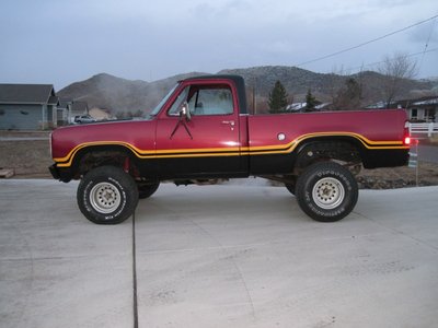

And the truck.
And if you have more tips please post em.
