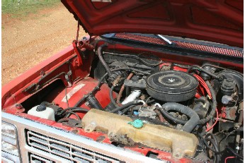

I am wondering where everyone's emission stickers are? On my D200 club cab with the 400 it is on the valve cover but on the 360 valve covers there is not a real good spot for the sticker. Any body have a pic or suggestions where to put it?

Got the water pump all sealed up and all the brackets put on as well. I had to stop working on the truck for a little bit while I fixed a home plumbing problem :twisted: But the engine will go in soon. I will put in new torque converter on friday (day off) and also a new tranny input shaft seal, power brake booster and master cylinder while I am in there. It is well on it's way to a great daily driver. Some one please answer my emissions sticker question. Where does it go?

("Some one please answer my emissions sticker question. Where does it go?")
I have a '79 and it's on the passinger side upper/top inner fender panel. It's a white sticker about 2" wide and 9" long. Has information about emission certfication (49 state Fed) and timing & size of engine.
Picture is attached:

It looks like they changed the sticker size from 78 to 79. Mine is about 3 inches tall by 6 wide. It is white with green writing. Thanks for the reply though! Any body with a 78 have a picture or description of the location?
