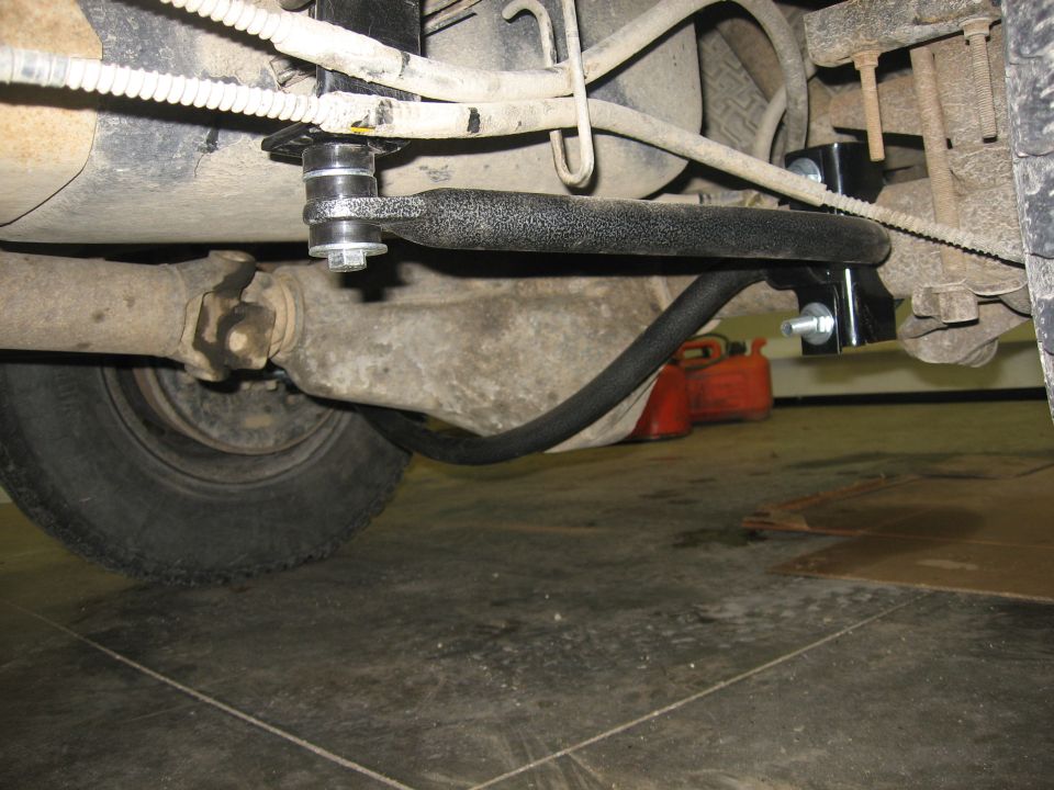

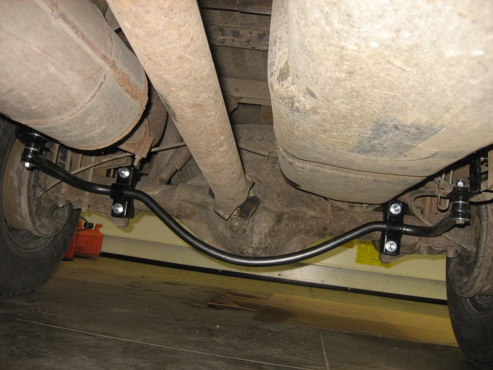

Finally waited long enough, ordered and installed one of those Hellwig rear sway bars that Sam told me about. Installed on a '92 W250 Cummins. Easy install, 1 1/2hr-2hrs. No drilling. About the same diameter as the front, 1 1/8" dia. We'll see how it works out this week! Would most likely work on the 1/2tons also, IF you have a front one on there too. Take a look. And if you had a lift, I think you could extend the end links. Bigger than those ones I see on the new factory Phords..
-Jim

should be a nice little upgrade. mt D350 had a dana 80 swapped in, but also had the attatched sway bar. i could definitely tell a difference over my last dually.

Ya, it's a GREAT upgrade. I worked 200 miles of mountain roads with it today, it's little different getting used to no body roll! Have 4 rigs to haul this week so we'll have to see how well it works with the load too. I'd recommend them, they're on sale, and also $20 off promo deal, pays for shipping!

Hauled two rigs today with that cummins with new rear sway bar installed. Handles super nice! I recommend it! Makes we want to drive fasterrrrr.... ! : D
