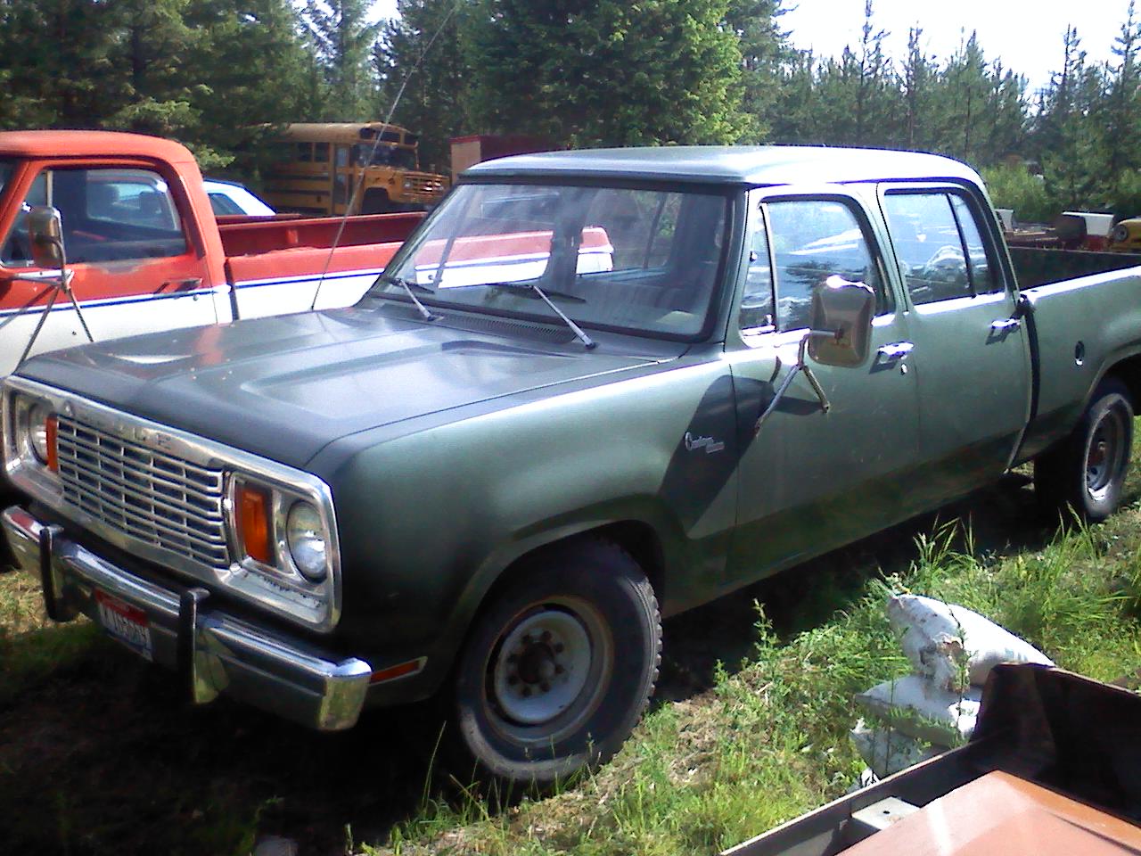

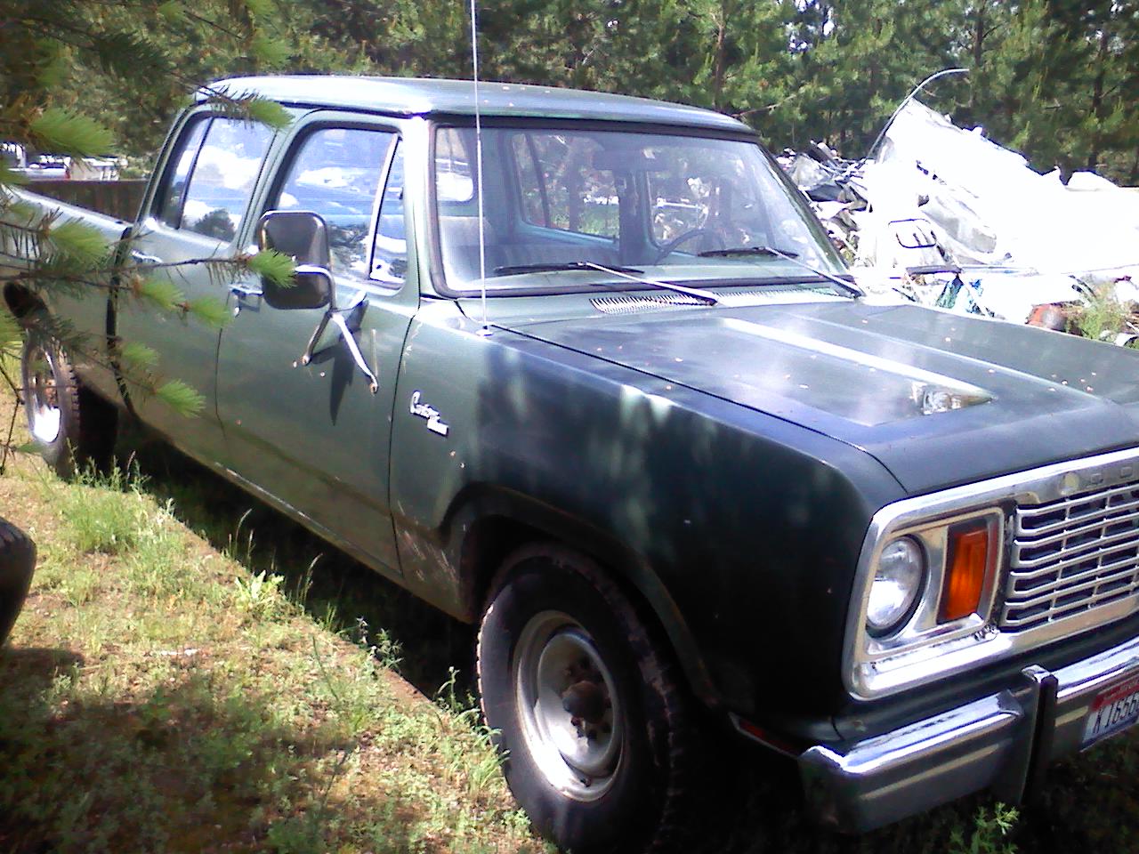

Found another nice '78 Crew cab 2wd, originally 6cyl, 4speed 4.10 truck, now a 383 4bbl, A833 4speed truck. Have a '93 cummins donor truck with a 5speed, have either a Dana70 3.07 gear or Dana 80 dually 3.55 gear. What do 250 crew cabs come with, dana60 rear? What to do?
-J

yes, it would have a dana 60 rear in it....
if it were me....I would go with the 3.07 rear end...have awesome fuel mileage, and pull in 4th gear....have 5th for going home...
