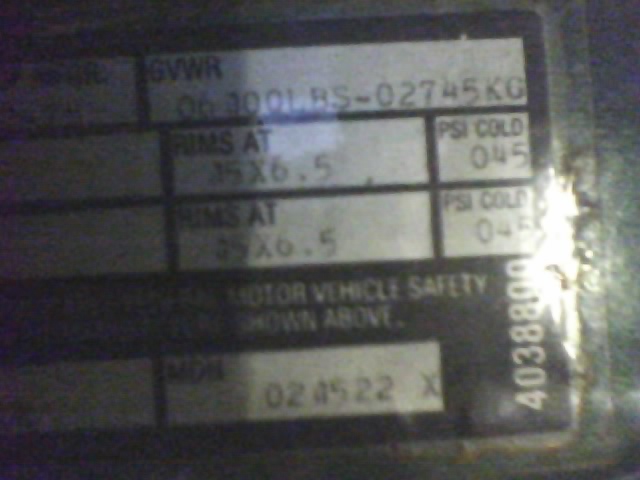

Thx, Sam. The 8-25-78 date is based on info given to me based on the MDH on the truck`s sticker, but I`ve found nothing else online... Thx for clearing up the q on the 74 440 trucks. I`ve been dubious as to that applying to "all product lines", there seems to be a fair # of 100 and 150 series 4x4 440`s around... I`ve included a pic of my MDH, maybe some one here knows how to decode them?? Mine doesn`t make sense, in that format.

Your MDH looks like 024522 from the picture...
02= Feburary
45=???????? maybe it is 15 or 25...which would be the day of the month
22= 10 pm at night....military time

Thx Sam, I thought that the date I was given was off - sticker says 2-78 i believe (havn`t cleaned it for fear of damage). At first I thought it was 8-78... So I`m also thinking the 45 has to be a misprint or somebody on the line had a sense of humor! Do you know what the "X" denotes? I`m still trying to locate the original owner, I have some Q`s. I do believe my truck is original, I know the past 23 years of it`s history (10 of 2nd owner, 13 of me). I`ll call you later, thx for the help Sam.
