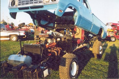

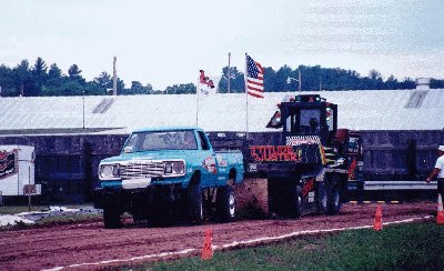

Dug these out of the stash,
Was on the pit crew with this machine,
1978 Dodge Power Wagon Super Stock Pulling truck
530 cid, 440HP block stroker, indy cylinder heads and intake, 1050cfm+ holley, custom open headers
Reverser 1:1 forward gear box, 2:1 reverse ratio
Profab quick change transfer case
single speed Rockwell 2.5ton axle
Dana 60front
A great truck!
-Jim
