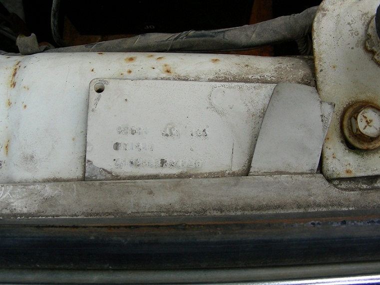

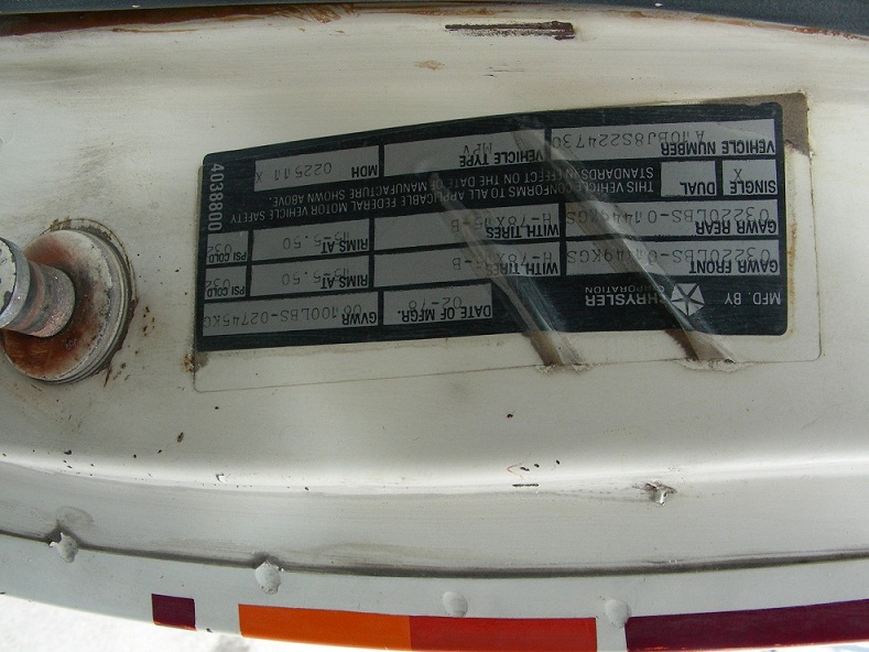

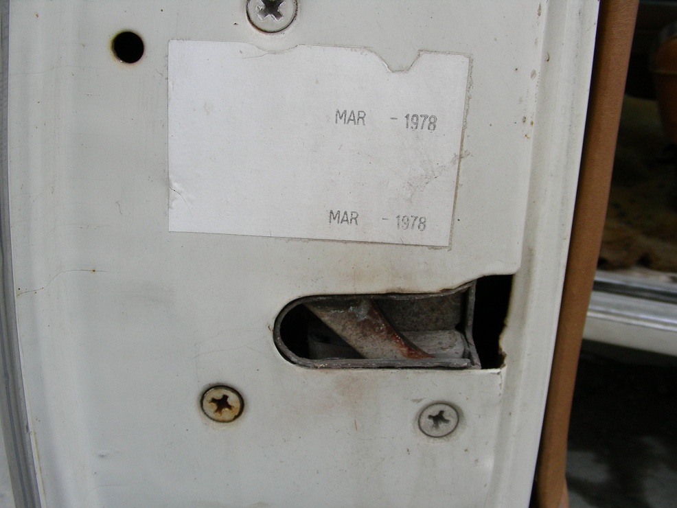

A couple more pics, I think this may the top hand tag on the door jam. It's pretty fadded but you can see 1978 on it.

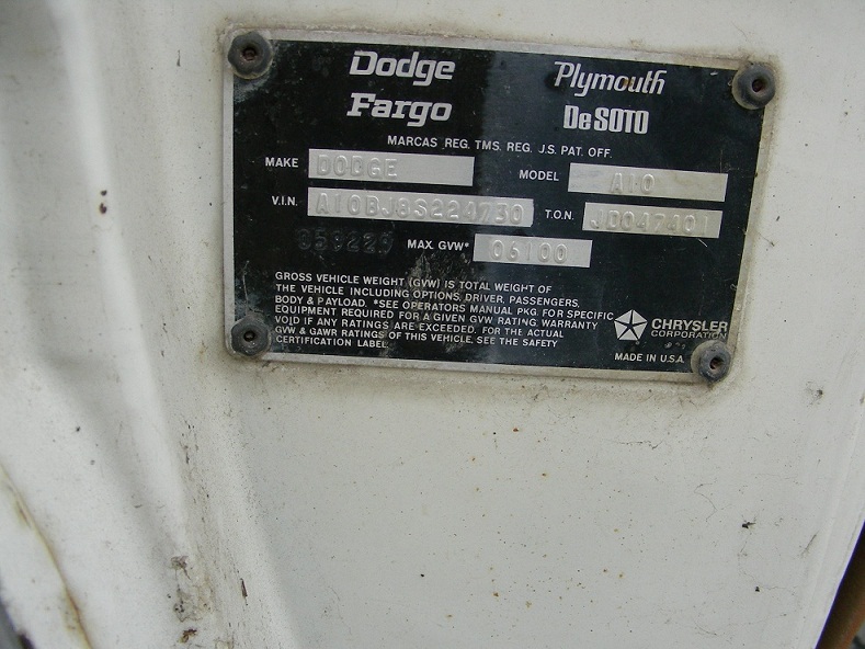

actually I lied, data tag on door

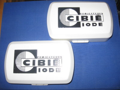

Saw these on ebay and was thinking about puchasing these. I believe they look to be exactly like the one that came on it.

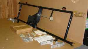

Decided to add the rear tire carrier and this thing is very heavy duty and very cool. It does not attach to the tail gate at all. Just the outside edges. Came with intruction and every thing need to put it on. It opens up in the middle and swings out. Ordered up a couple of metal jerry cans, one for water and one for gas. Getting ready to paint the rack out to match the truck like it should be.

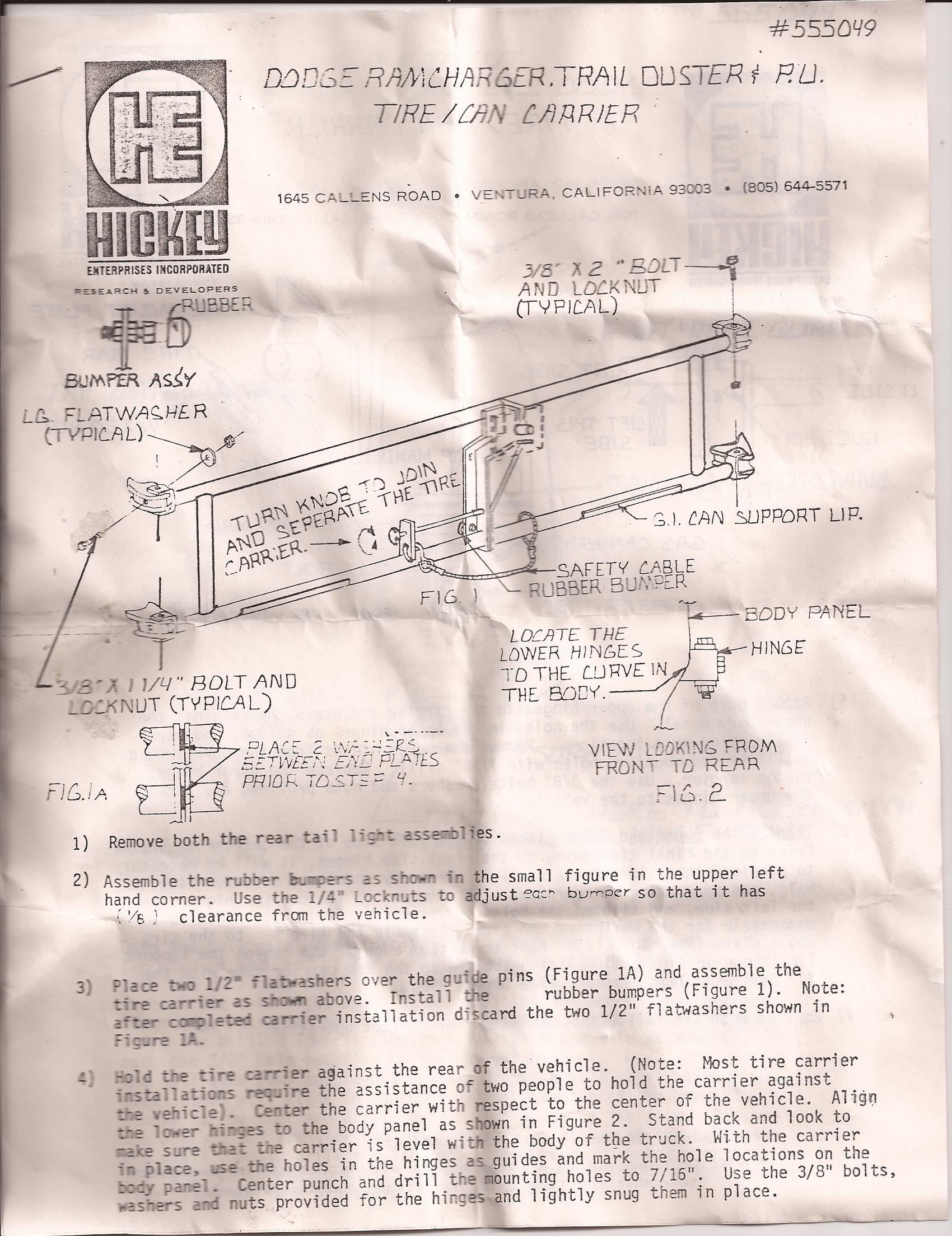

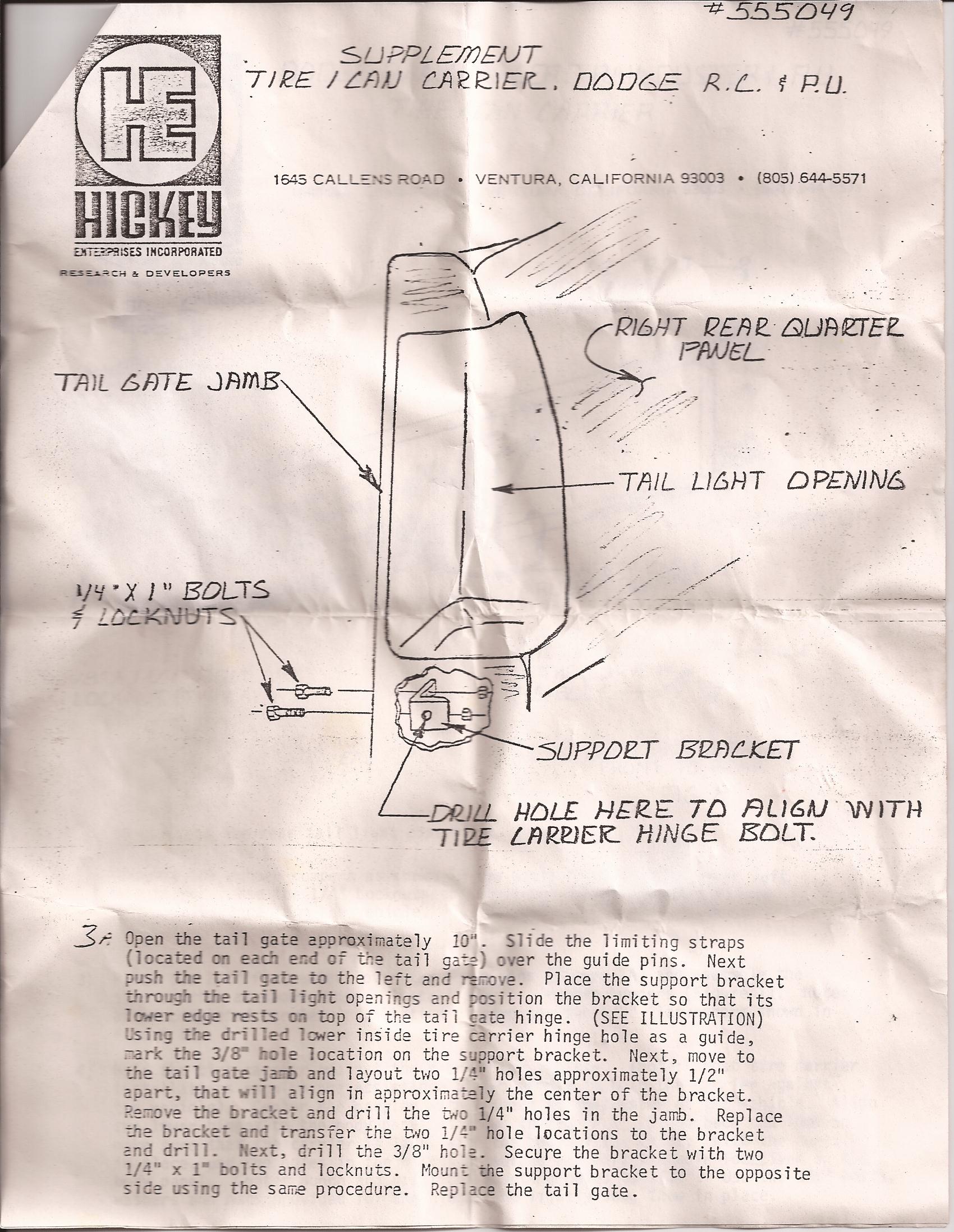

Thought some of you guys might like to see the instructions for the hickey rear tire rack.

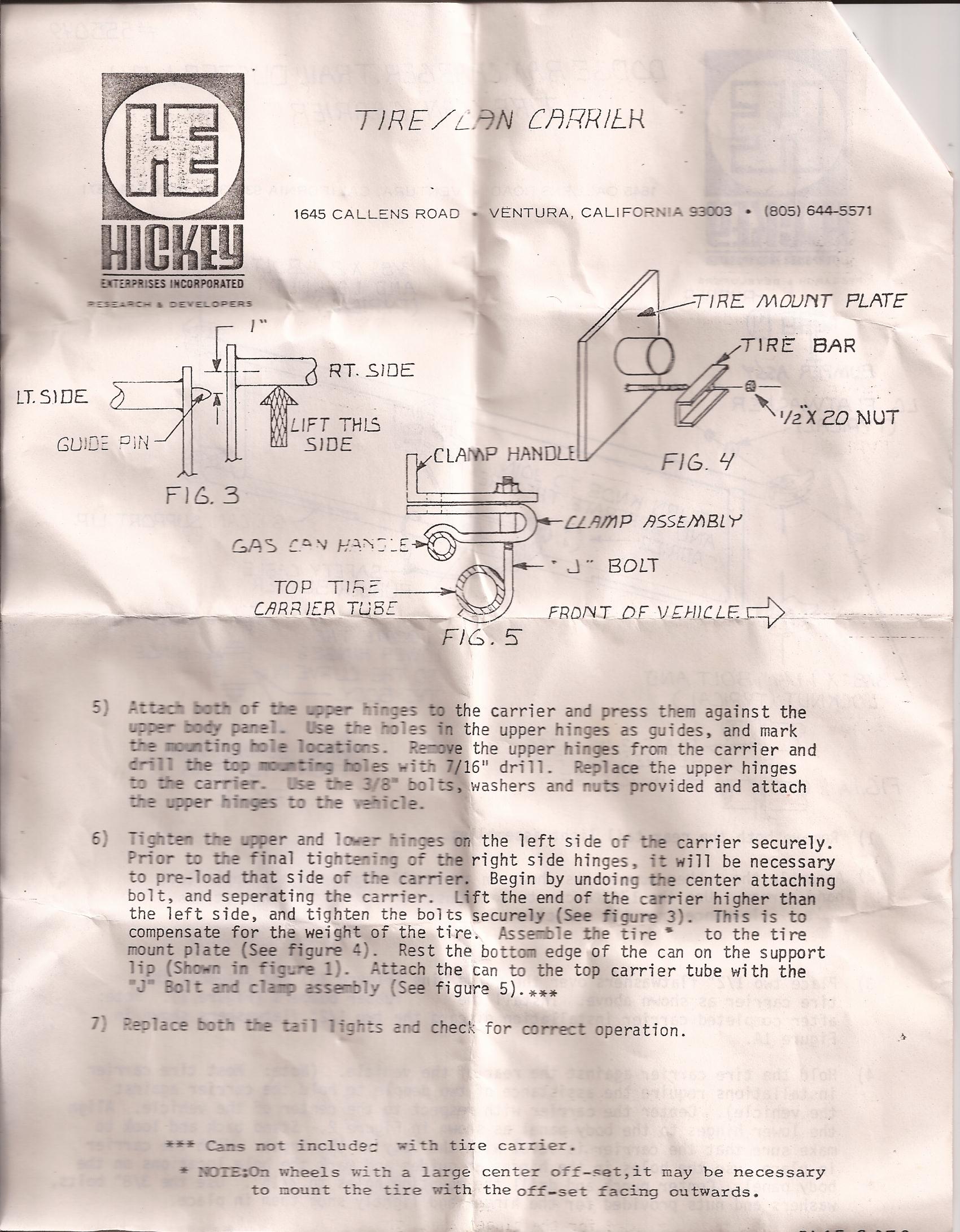

Page 2
