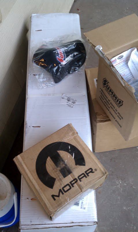

Sure do like coming home after work and finding presents on my porch. Thats the headers and balancer. The last stuff for the motor. I plan on installing the motor next weekend. I'm using this weekend to clean the engine compartment and put the finishing touches on the new engine. Oh and look, you spend enough money, they'll send you a "free" hat. LOL!

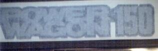

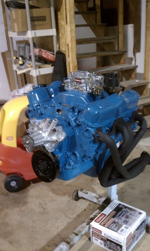

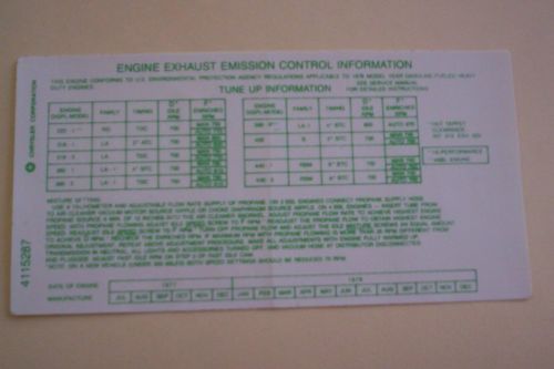

Engine bay washed. Motor complete. All parts here. Going in Saturday. Look... I also found a pair of NOS "power wagon 150" side decals and a NOS emission sticker for the driver's side valve cover.

Wow! That engine looks great! I had couple of questions for you-
1) I see you went to a 4 barrel carb- where did you get your kick downlinkage or did you just but the stock set up?
2) Where did you get the emissions sticker? I am in the process of doing the same thing to my 360 and want a sticker for it...
