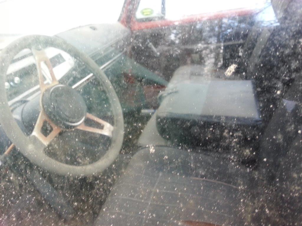

I'm going to try and get the seats out of this lil red for my macho this weekend. There better then mine, I'll still need to recover them though as there brittle.

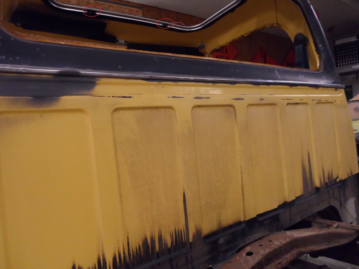

Jeff, do you have the black pieces that the sunroof hooks into on the front of the sunroof? There attached to the sunroof frame.
Also notice the roof black out by the rear trim, you can tell they did it pretty quickly as you can see a lot of the black below the trim.

I'm debuting on leaving the sunroof frame in the truck and taping it off. I've taken one out before and it didn't nearly go in as tight as factory did it.
