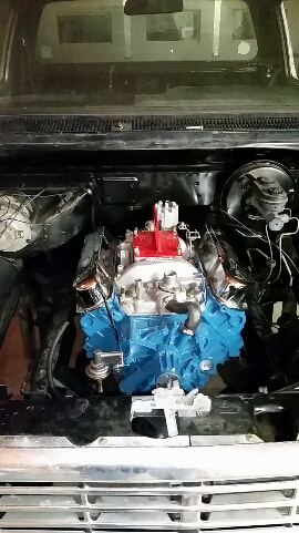

Got the original 360 rebuilt and back in.
Does anyone know where I can find a 79 or 80 engin compartment wiring harness

Got the original 360 running had some trouble with spark at first so i installed a speed master ready to run distributor and it lit up and ran beautiful.

Looks great! What pistons did you end up using in your rebuild. Also what intake did you go with? If you don't mind saying?

I used .040 over cast aluminum pistons and the intake is a edelbrock performer 318/360 with a 650 cfm holly 4bbl on it

Cool. thanks. headers or manifolds?

Full hooker exoust from the headers to the tail pipes
