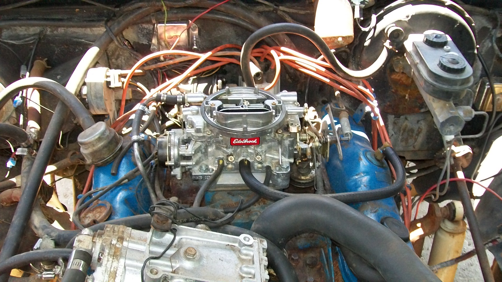

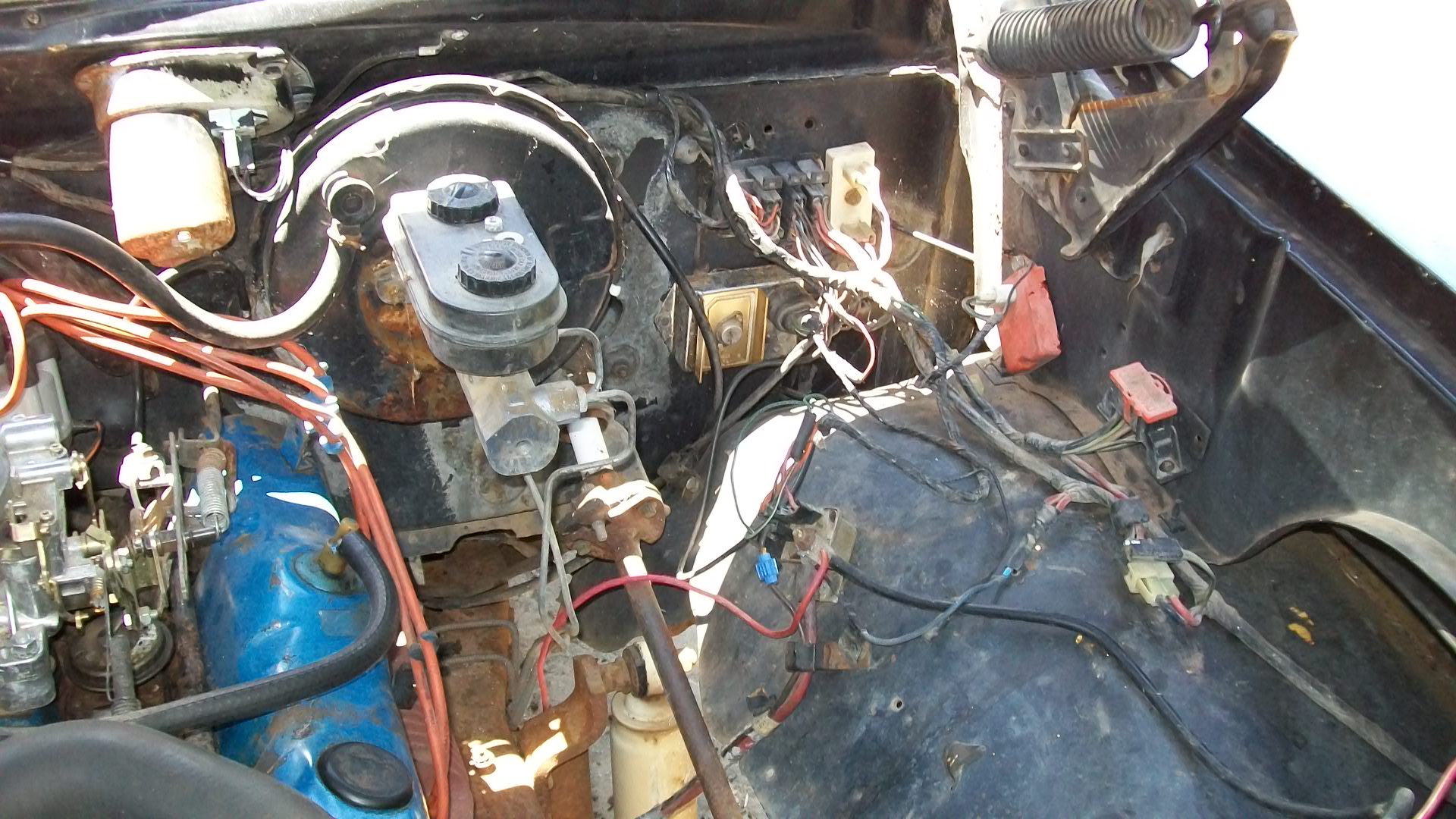

I got the wiring harness installed..2 mods that I still need to do, but the 79 harness is in, and the 80 harness is out, for the exception of the rear lighting harness(where the mods need to be done).
it runs nice....pump the gas 2 times when it is cool, and it lites up and runs great!
File comment: eddie afb from off of my shelf....just until I get the TQ rebuilt...the Eddie runs GREAT, but won't pass emissions here..

File comment: drivers side of the harness

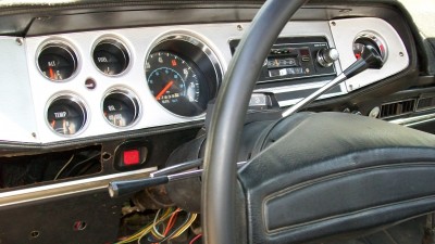

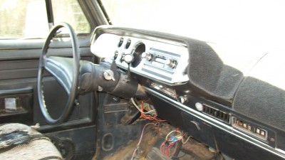

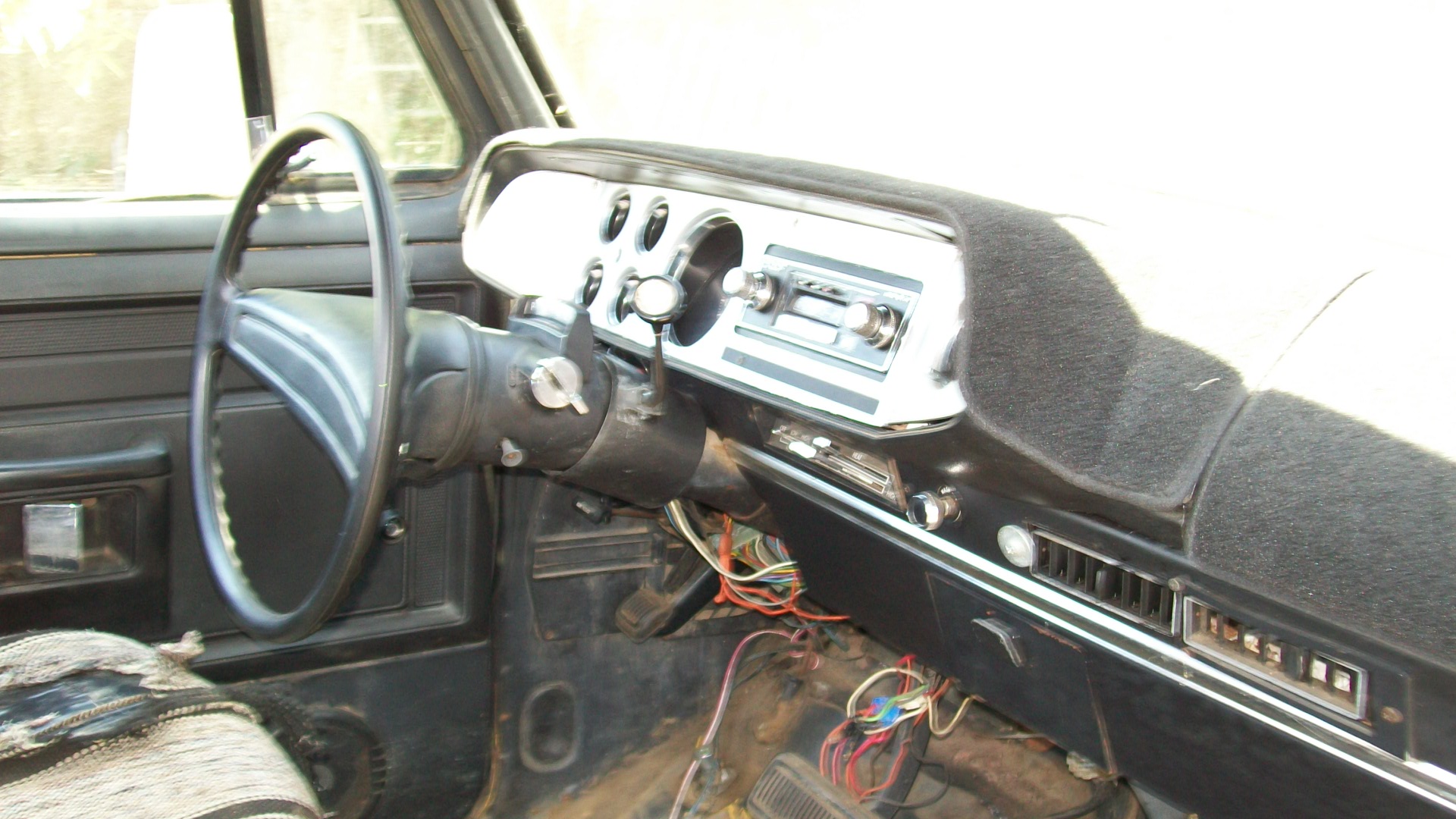

dash pictures....
It looks like when the truck got painted in 1983, they also painted the dash benzel black too.....upon further inspection it looks to have been an original radio delete truck....
since there is no buildsheet as of yet, I am going to add a few factory options to it...like clock...
Also...the dealer installed a/c vents look almost like the factory ones, and in a very similar if not the same location....a factory a/c metal dash is probably going to replace the hacked one....
there is something to be said about all of the dash lights working and being nice crisp and bright...
mental note....the tilt steering bulb is a PIA to find....Kragen/Autozone bulb #53 is the one for it...make sure to save the blue light condom for the new bulb(diffuser), as ma-mopar don't sell them anymore
Installed my am/fm/cassette/cb made by clarion...essentially it was the same unit, but the old unit was 8-track, and was broken and missing the mic controls....
File comment: dash looking from pass side....

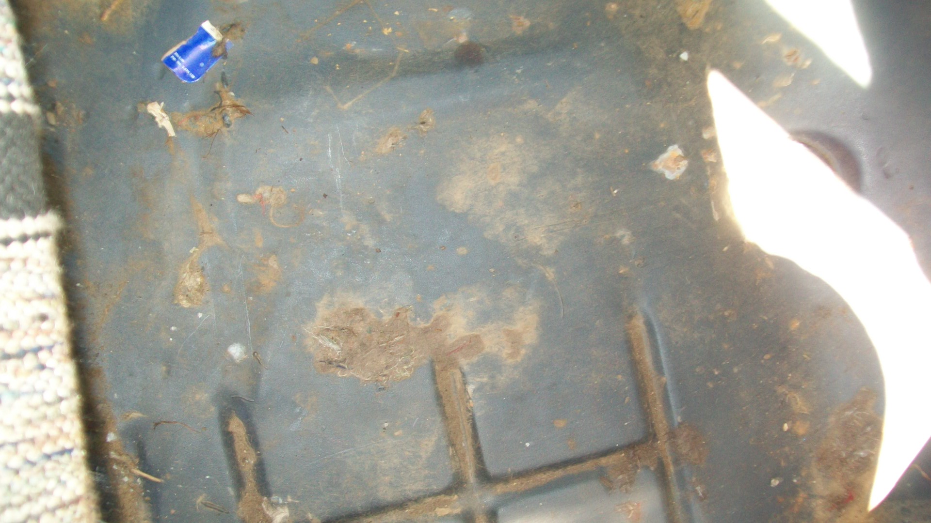

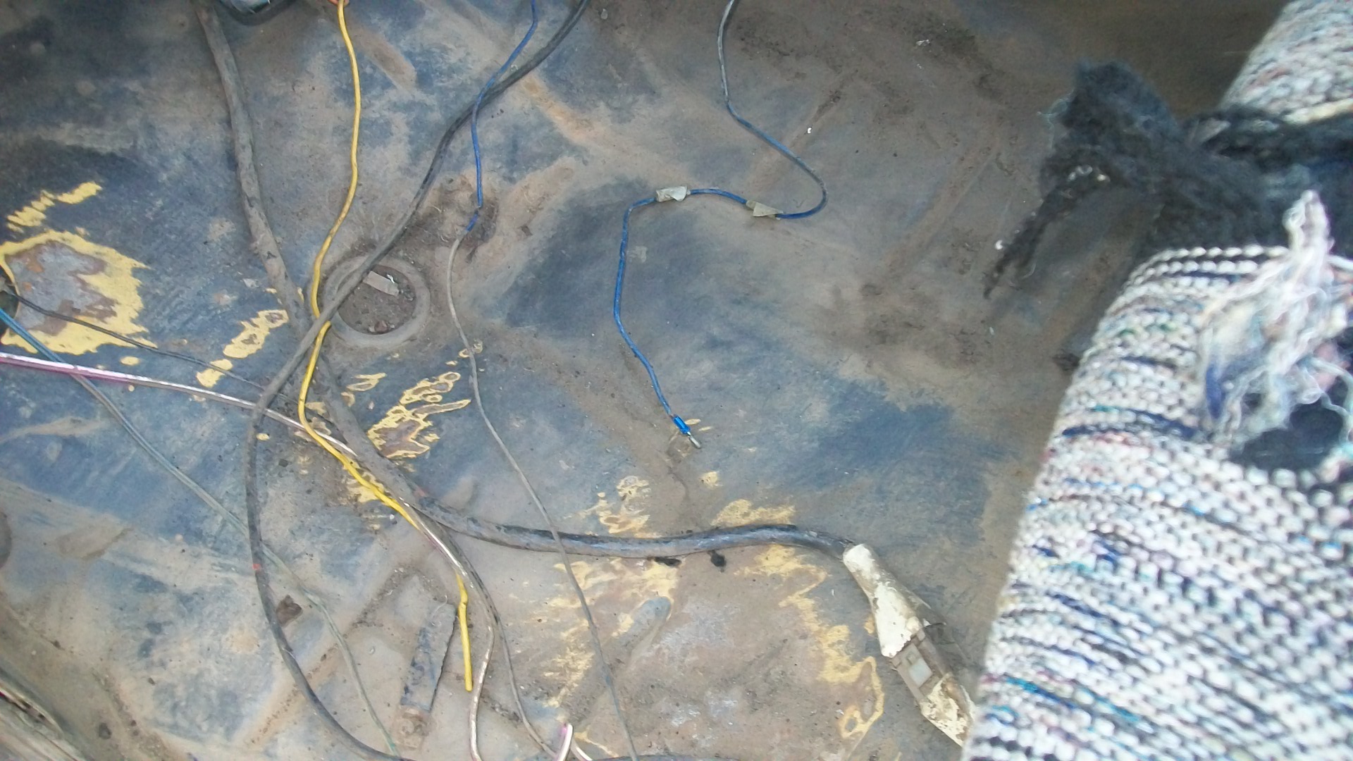

pulled the carpet out this morning....I know it is going to be replaced, but for now I will clean it and put it back in for the time being...
plan is to get it restored semi soon, but we all know how life can be, so it will be going back in once it is dry again....
BTW....darn nice dry rust free floors.....nicest I have seen in a long time!!!
File comment: pass side floor...no rust...
