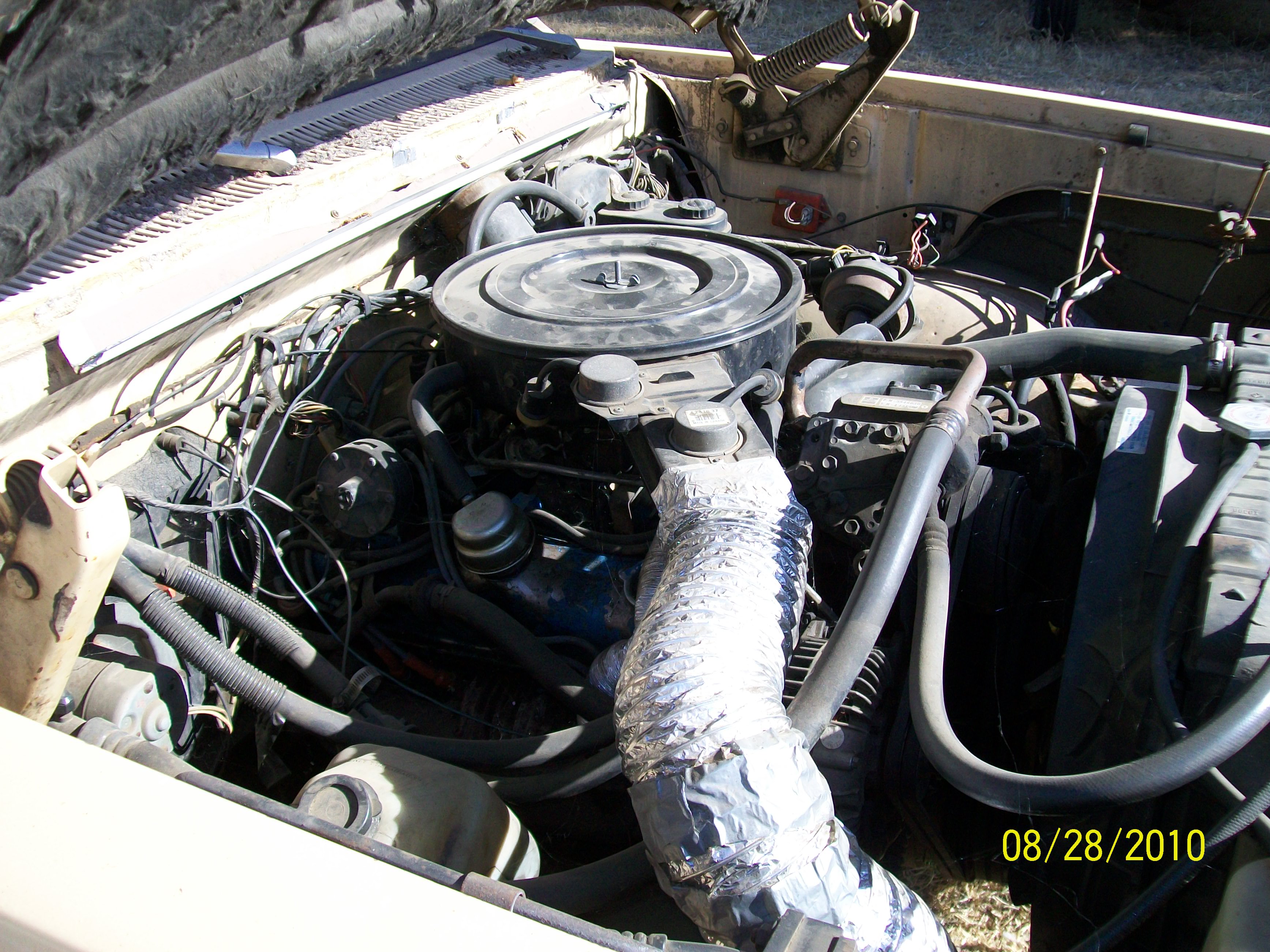

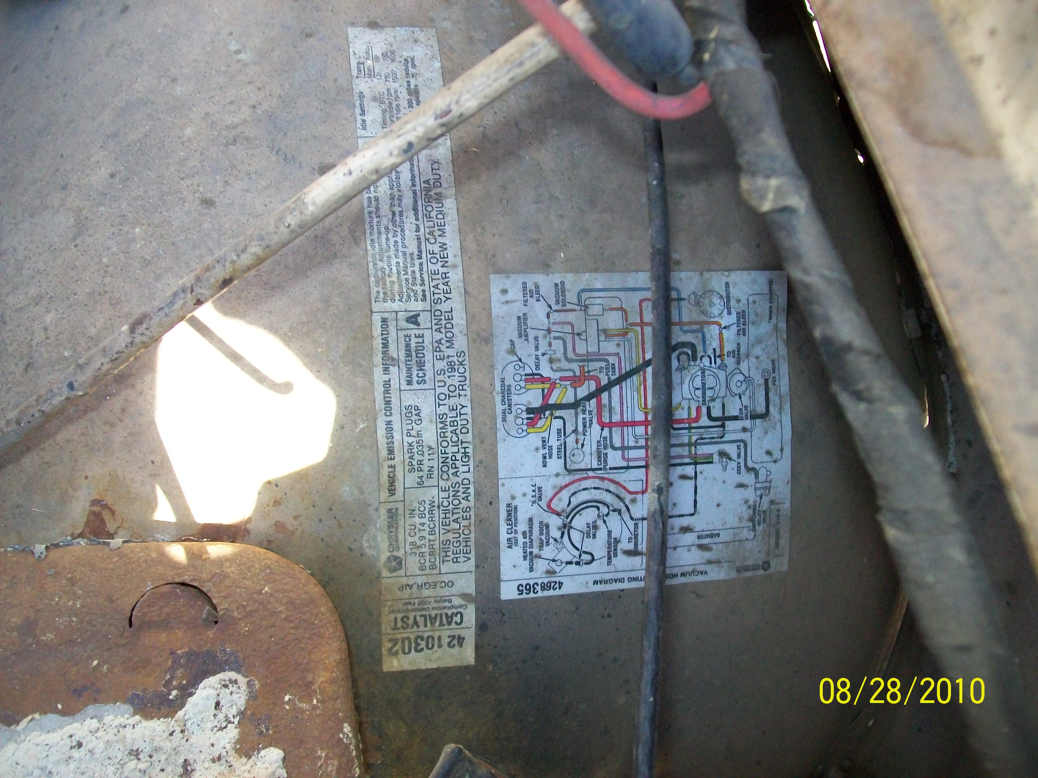

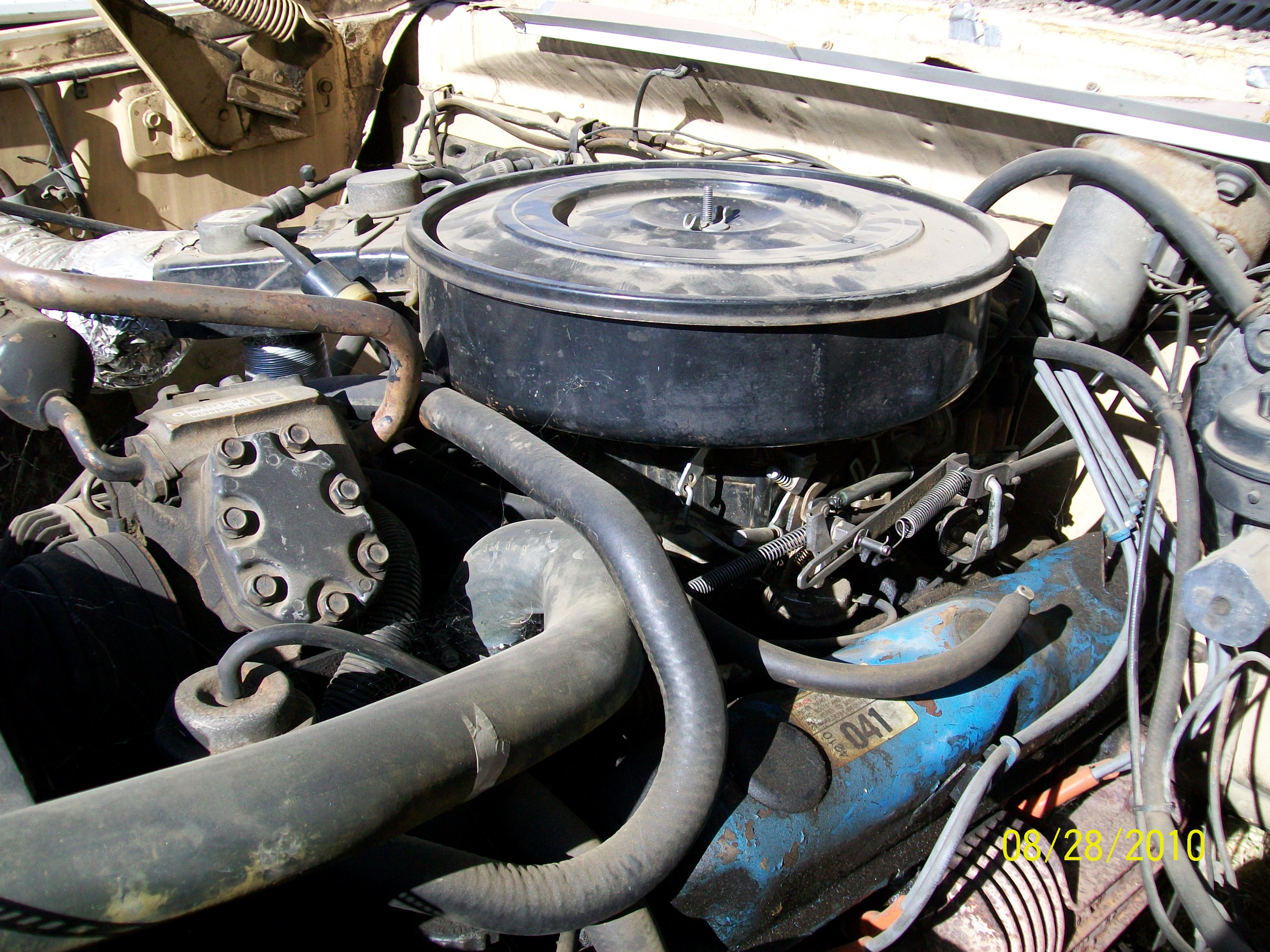

PostPosted: Sat Sep 17, 2011 3:46 pm
engine pictures....
correct air cleaner is a 1 year only piece and same for some of the emissions stuff...
this one pictured is on a 81 Big Horn with 318 and cal emissions...
 Post subject: Re: My 1981 MACHO
PostPosted: Sat Sep 17, 2011 3:49 pm
hope that helps some...sorry about the un-cleanlyness of the engine compartment, it is in as found condition still....

Thanks for the pictures! Yesterday we took the girlfriend's car in for emissions -- and while there I asked the assistant manager (at the state-run facility) what all an '81 needed emissions wise ('81s and earlier simply get a 2-speed tailpipe test). She claims that it needs all of the emissions equipment present on the sticker in the engine bay. Now in Denver there are about 10 independent (non-state run) emissions shops for 1981 and earlier vehicles -- supposedly they're more lax and as long as the vehicle passes (regardless of equipment) you're good to go.
I took some time examining different '81/'82 trucks at the yard yesterday and my truck really has none of its emissions equipment left. I pulled a sticker off of an '81 D300 crew cab (HDC) and it shows a much more limited amount of emissions junk.
