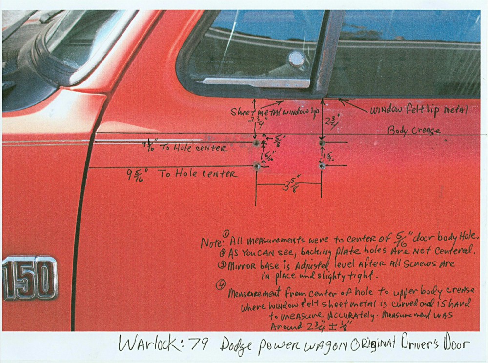

Hey those mirror mounts are nice.
I have the specs for proper mounting holes on the door of a '79 Warlock.
I will post the photo spec.
