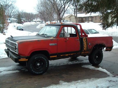

Here is what I am starting with, except for the 16' wheels taken from my Ramcharger to get it home.
File comment: Starting Point

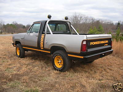

PostPosted: Tue Dec 07, 2010 11:03 pm
