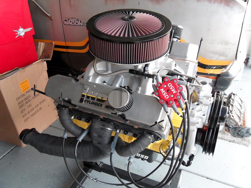

Hey gents I need some help finding a compatible bellhousing for my Macho. It had a 318 in it, I built up a 440 for it and I still have the manual 4 speed. The engine did't have the bellhousing and there are a slew of them on ebay,I just don't know what model #'s are compatible for the 440 4 speed combo. Also are the motormount locations in the same location as the 318 or will I have to weld on new mounts??? One last question, my instrument pannel needs to be repainted, its that siver color. Is there a rattle can that matches or do I just have to come close with a color??? Any help would be greatly appreciated.

Here's a good webpage for bellhousing part #s
http://www.mymopar.com/index.php?pid=71
I think theres a misprint on the truck ones, you are looking for the NP435 trans, its says 833 trans.
They are tough to find, and cost some $$$, I have a late 60s,early 70s one but I had to pay $$$ for it...
Dunno on the gauge bezel, someone should be able to answer it for ya.
