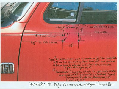

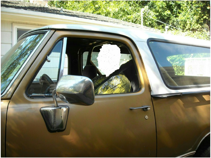

I have a 1977 and from what I have seen it appears there were three or four mirror options. Mine has the small square mirrors like the LRE and I would like to install the bigger ones that have the big chrome base. Does anyone know if both of these types use the same mounting holes?
 Post subject: Re: mirrors
PostPosted: Sun May 14, 2017 3:47 pm
No they are not,,,,but the later base metal under the chrome can be re-drilled. Here's a couple of photos that might help you:
