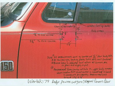

I have a 1977 and from what I have seen it appears there were three or four mirror options. Mine has the small square mirrors like the LRE and I would like to install the bigger ones that have the big chrome base. Does anyone know if both of these types use the same mounting holes?

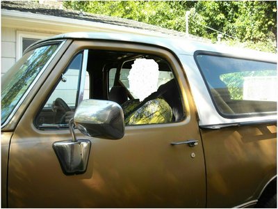

No they are not,,,,but the later base metal under the chrome can be re-drilled. Here's a couple of photos that might help you:
