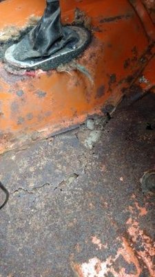

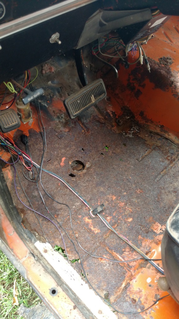

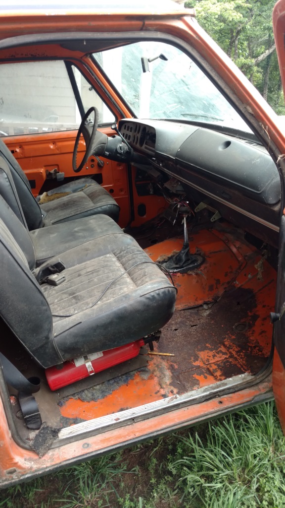

Got the seats and carpet out and the exterior washed. Nearly all the mouse remnants have been removed. Likely some left behind the dash. Going to need some new tubs and some metal work around the seat belt mounts.

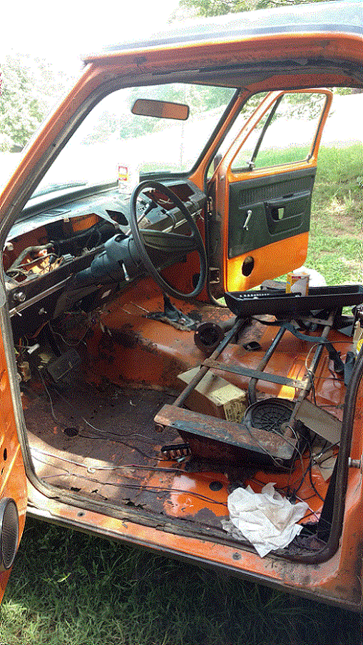

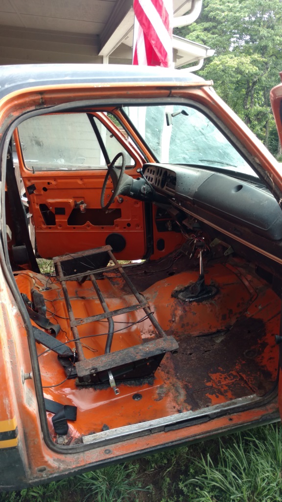

Does the window need to come out to get the rest of the dash out? Found the two bolts at the bottom so it's free'd up but don't see any other mounting points up top to get it the rest of the way out. Thanks in advance!
 Post subject: Re: 1978 Power Wagon Macho Project
PostPosted: Sat Jun 03, 2017 2:40 pm
Joined: Tue May 23, 2017 5:45 pm
Posts: 13
Sounds like there are some bolts hidden under the seal for the windshield so I guess it needs to come out...
