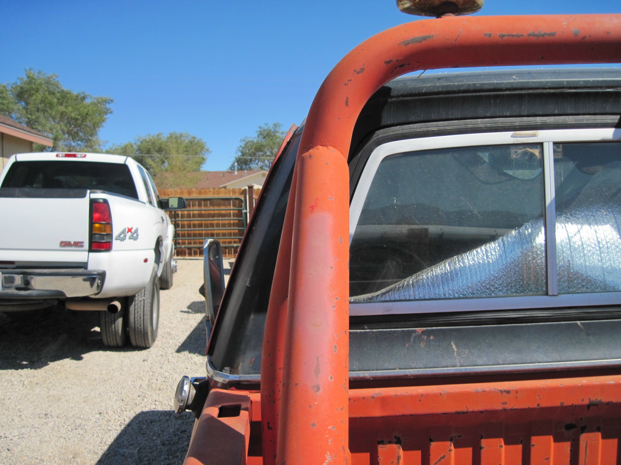

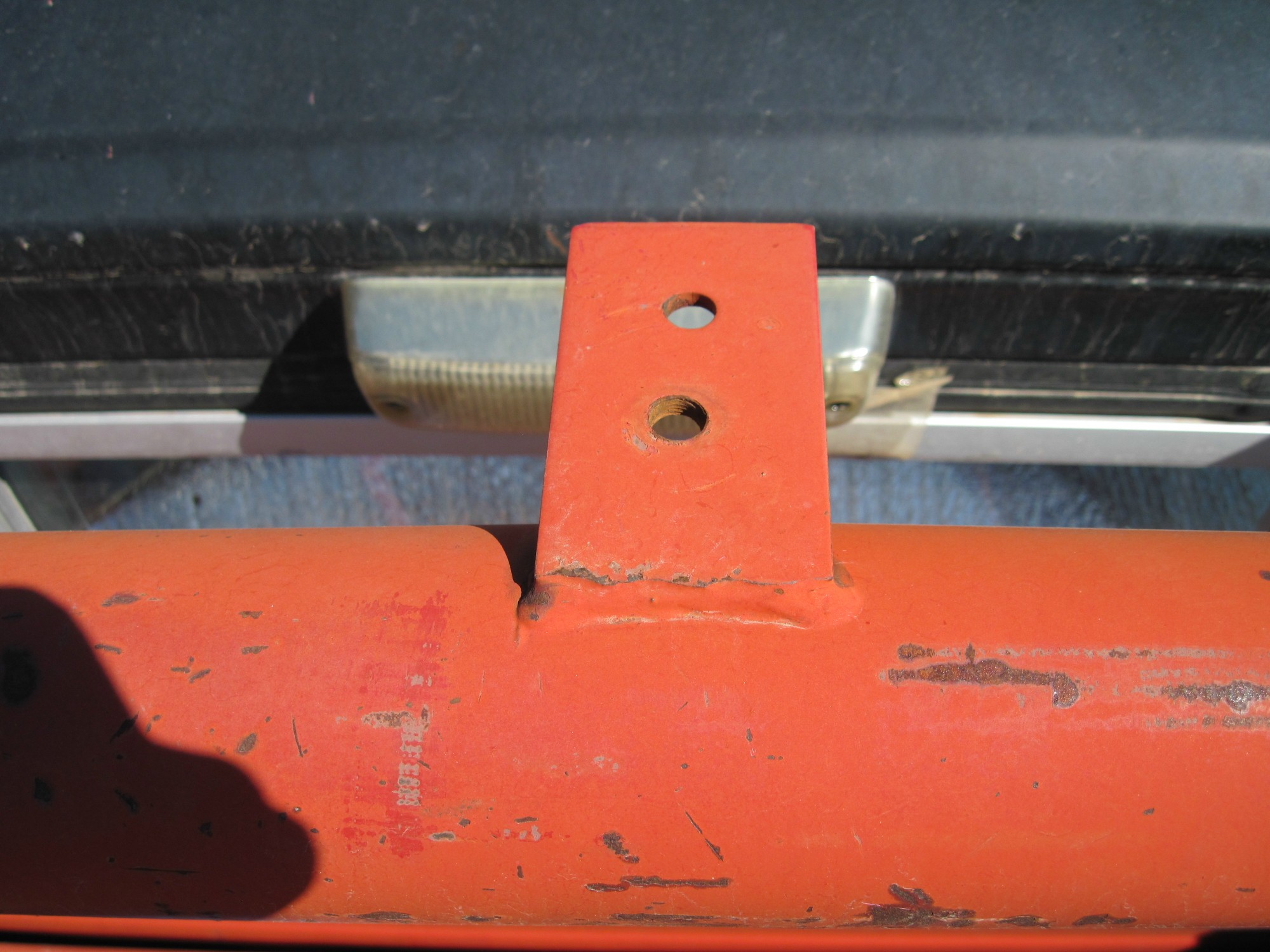

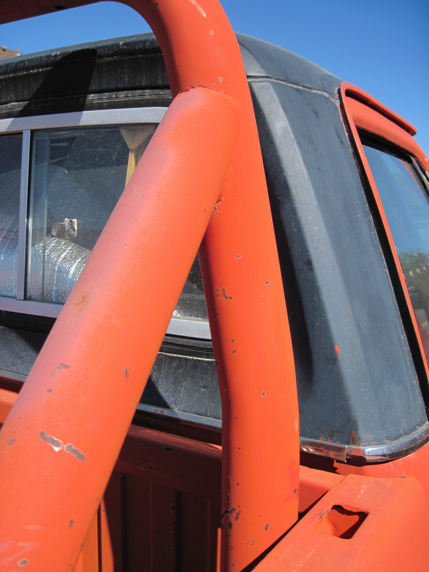

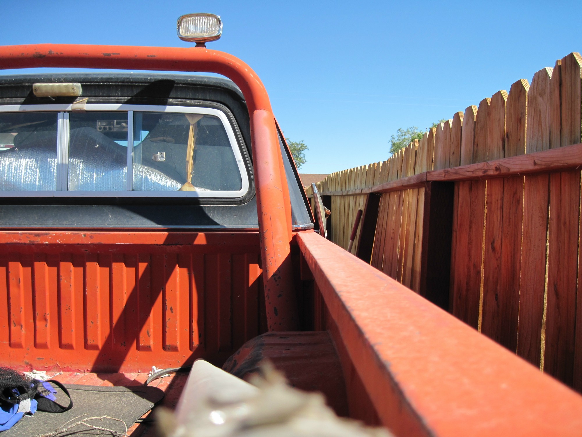

3 inch OD on the tube
Top of bed floor rib to bottom center of bar 40 and 1/4
Top of bed floor rib to bottom at outer light tabs 39 and 1/2
Main bar from floor to first bend 22
Across main bar Inside at the top of the support welds 53 and3/4
Light tabs are 2 by 3 and 1/2
Outer tabs distance inside 38 Then 18 each
to middle tab
Distance mounted of bar to top of bed (front) 1 and 1/4
Top length of support bar from plate to main bar 33 and 1/4 including weld
Main plate 7 and 3/8 by 5
Support plate 5 by 3 and 1/2
