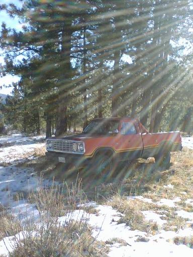

And I'll attach a picture of the beast you can drool over. I can try to get more later.

Wow, nice truck, unfortunatley I don't know the answer to your question, but many on here do. Thats one of the few long bed machos I've seen. Also, how do I attach a pic of my truck?

Thanks dodgeguy, yeah I like the long bed. Unfortunatley, had a minivan back into the side of my bed. So need to find a new one.
