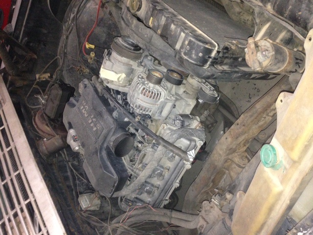

A 78 I picked up a couple years ago.
Was 318, a/c 2wd. It came from Arkansas.
I'm in sask Canada.
I have most of the parts to do the swap.
Bouchilon kit for ac and e body headers.
Zex nos kit.
Doing it up as a midnight express.
I need motivation!!!

PostPosted: Fri Jan 10, 2014 2:58 pm
Joined: Mon Dec 30, 2013 11:40 pm
Posts: 6
I am swapping to newer style black plastic valve covers and one coil for both plugs.
Hot wire auto made the harness and flashed the ecu.

Is this a very expensive swap after you already have the motor?R u using the original tranny or the newer Hemi tranny ?Keep us posted on your progress!

Can't beat a factory ecu.
I'm using the 727.
Headers and harness are where most of cost is but I hope will be worth it.
I'm using Doug's e body headers. Minor grinding on frame.
