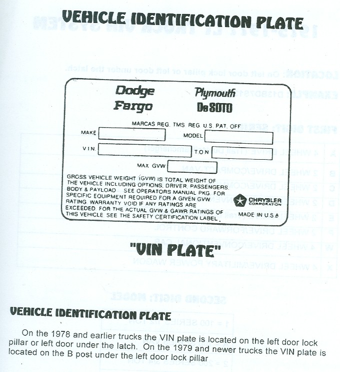

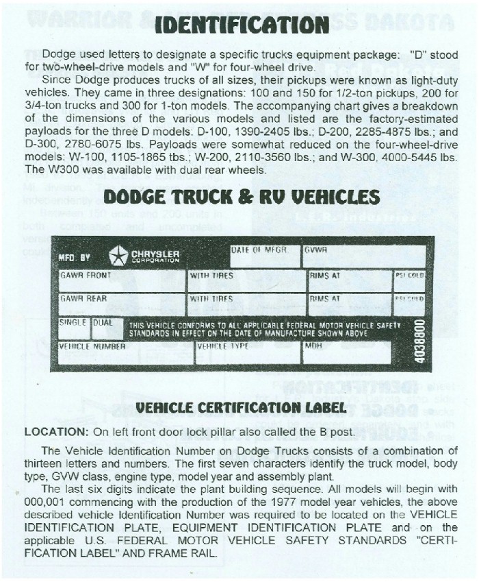

I recently bought a project step side 1979 D100 custom in basic trim and need to bring it back into DMV system. However I need to get a picture of the certification label (for GVWR etc.) and the metal VIN tag. Both are on the door jam. Can anyone help? Need to show C.H.P. what it is supposed to be (both of mine were lost by painter). As close to my VIN as possible is best. My VIN is D13AP9S228921. A readable picture is great. Tape off the last few #'s of the VIN if your worried. Thanks

What State are you trying to register? In California the weight certification label is not needed. The information is on your vin..... D13AP9S228921::: deciphers:

In California, DMV will send you to a Weight Station for Laden Weight Slip. Then you will register your truck with that laden weight certificate.

V.I.N. is also stamped on your frame. Right side passenger rail, outer horizontal area forward of the axle hump and before the rear main body mount insulator.

I would brush off the frame VIN and show that to the CHP. After documentation with the CHP,,,, DMV will issue you a new VIN plate and the CHP will install it. Go to RCC.com and use their VIN decipher page and print it for the CHP.
